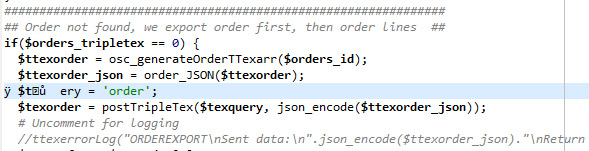

I opened the file, wrote some code and saved the file.
That's it.
When I run the code it failed with syntax error, which showed on which line it broke and on that exact line there was that weird character.
This time it actually was on 2 lines. Both times on a row with leading curly bracket {.
If I could reproduce it, then I would tell you exactly how it happened. But it does not happen that often.
From my observation it happens on bigger files. This one has 208833B.

I find this happens every once in a while after saving a file via ftp, in every instance it happens during an application crash. I only use ftp for my connections though. It will randomly replace a line (usually on a line that is visible on the current editor window view) with a random offering of extended ASCII characters typically starting within the first 5 columns.
Usually you don't find out about it until a script fails or a web page starts showing the strange characters.
I have had 3 crashes today after updating to 5.0.6 and in 1 instance ended up with the strange characters being present in the file. Typically I may see 2 crashes a month.
Can you tell us what information you need to track this down. Is there a debug logger we can access somewhere or a specific detail from the windows event viewer?

I had this again in 625.
Nothing special happened, no crash.
One thing to mention is that i opened the file 2nd time, causing the dialog "Do you want to reload the file?" and i hit Yes.
The file was opened via WinSCP.
Thats all i can think of.

After Copy/paste something like
if(!$search){
$foo = $bar;
there is EXACTLY this chinese sign somewhere at the end of original place. After accidently saving and closing the PHP file, PSPad will open the file in Hex-Mode.
I'm not able to reproduce this bug always. I got this bug only in larger PHP files yet, after using the file for several hours at once.

The strange characters always replaces a closing bracket }
I just experienced this bug in a file which was just opened, and added about five lines of php code to. It was a file which contained html, css, js and php.
My take on this is that this either has something to do with the syntax autocomplete, or/and syntax reading and coloring/formatting.
And, since it occurs so often, it may be caused by/or cause the memory access violation bug too?
