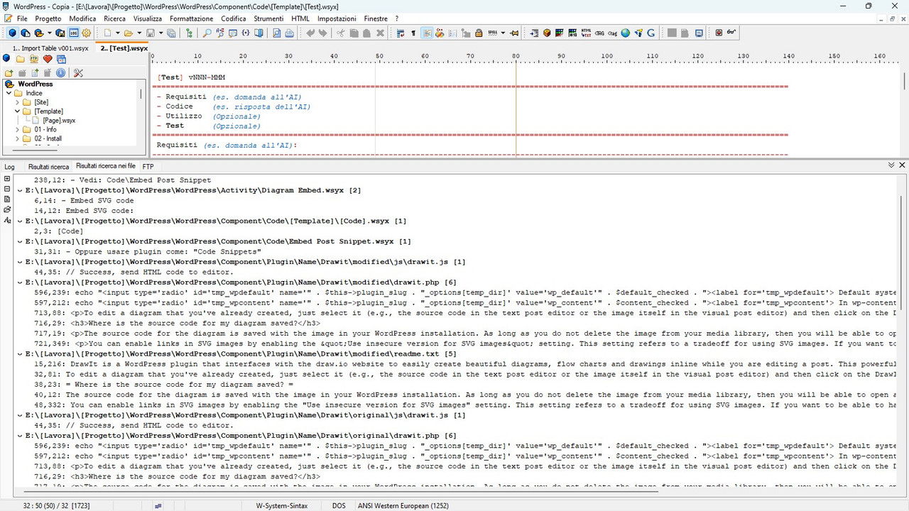

Posted by: Jonny | Date: 2025-08-19 09:40 | IP: IP Logged
Hello PsPad
First of all, thank you so much for your incredibly useful software, which I've been using with satisfaction for years!
Unfortunately, I have to say that I can't abandon PsPad version 5.0.6.589 for the newer versions, as the search function in the newer versions doesn't seem to work, at least for me!
When I open a project with many files and folders, if I search for a word in all the files, the newer versions of PsPad find the word correctly, but the links it displays in the results window when I click them don't lead anywhere. It always opens a nonexistent file, titled the number of open tabs, and the file contains nothing.
What could have caused this?

#6 Re: PSPad unicode 5.5.2 (831) English
Posted by: Jonny | Date: 2025-08-19 12:20 | IP: IP Logged
Hi PsPad
Thanks for your time!
The links shown on the search results page are correct, and they open the indicated files in Windows Explorer.
All the files found by the search are also correct, the contains the searched word.

#7 Re: PSPad unicode 5.5.2 (831) English
Posted by: pspad | Date: 2025-08-19 13:01 | IP: IP Logged
I see the problem - square brackets.
PSPad counts, that in square brackets is number of finds. It removes square brackets and it's content.
It should be easy to handle - I will go from the end or I will use other format to show number of finds.
Can you please tet it with other project what doesn't use square brackets in folder names and confirm it to me?
#8 Re: PSPad unicode 5.5.2 (831) English
Posted by: Jonny | Date: 2025-08-19 13:26 | IP: IP Logged
Yes, you were right.
I modified a project by removing files and directories with square brackets, and now the search works correctly.
The links now open the correct file, in the correct row and column!
