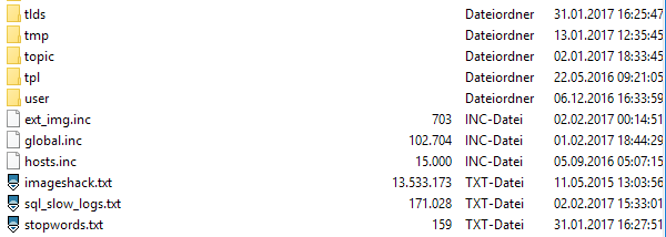

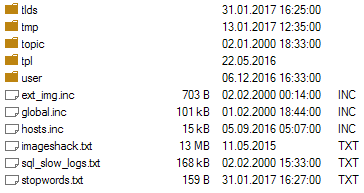

Since the first of february all dates are displayed wrong. This means if a file was modified "01.02.2017" PSPad shows the date "02.02.2000"
I'm using PSPad 4.6.1 (2730) with Windows 10 Pro 64-bit. I verified this Bug through Filezilla. It shows all dates correctly.
Screenshots:
PSPad
Filezilla

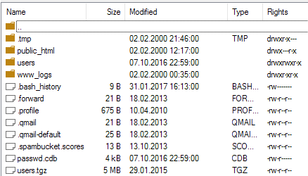

Compare with the screenshot and you see that tmp, public_html and www_logs have wrong dates:

Your server doesnt support MLSD command, what is file list standard few years already.
As you can see, it sends different format for files from this year and past years - for this year listing doesn't include year.
In the past each FTP server uses own format of listing files and this is a result.
I will try to fix it.
